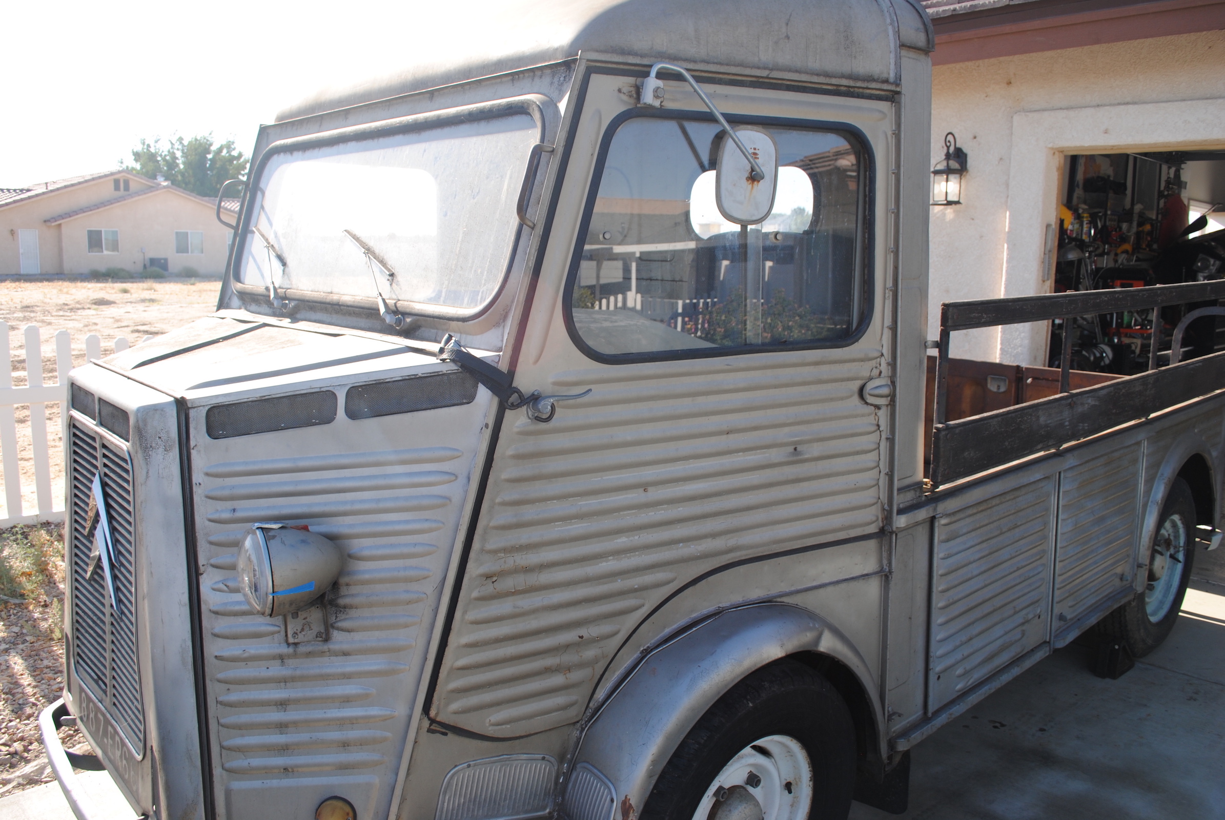

Hi All,
I'm new here and recently acquired an HYP Plateau pick up. It rained here a while back and the rear bed (floor) of the Plateau had 4 inches or more water in it. I pushed it out with a squeegee.
My question is should there be a drainage hole(s) in the bed perhaps close to the cab?
The bed seems to be rusting. Should I use POR-15 on it.
I live in California USA and do not speak Dutch so please forgive if this question has already been asked / answered.
Kind Regards,
Garric
Kind Regards,
Garric

Re: Plateau Pickup bed drain holes?

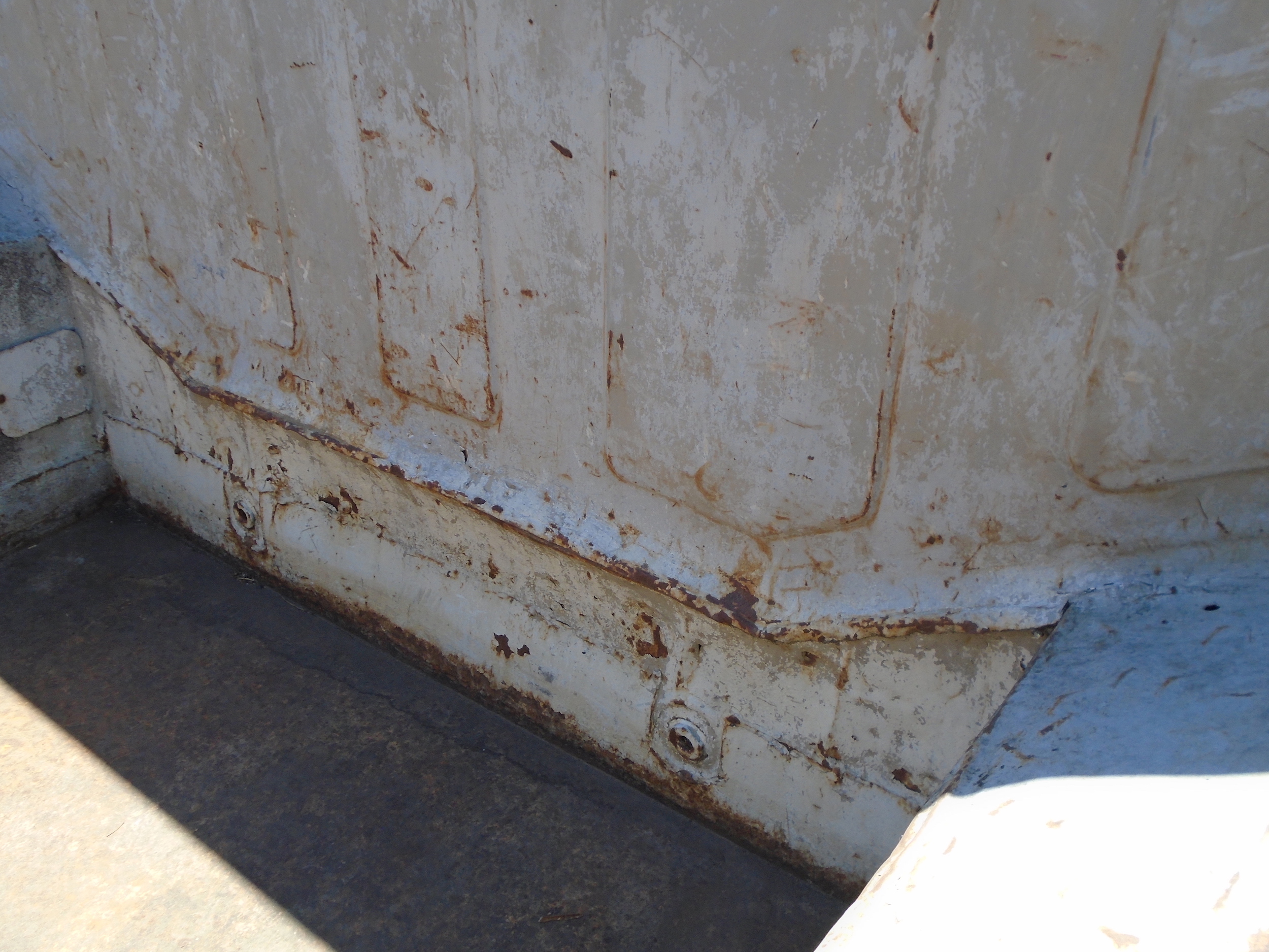

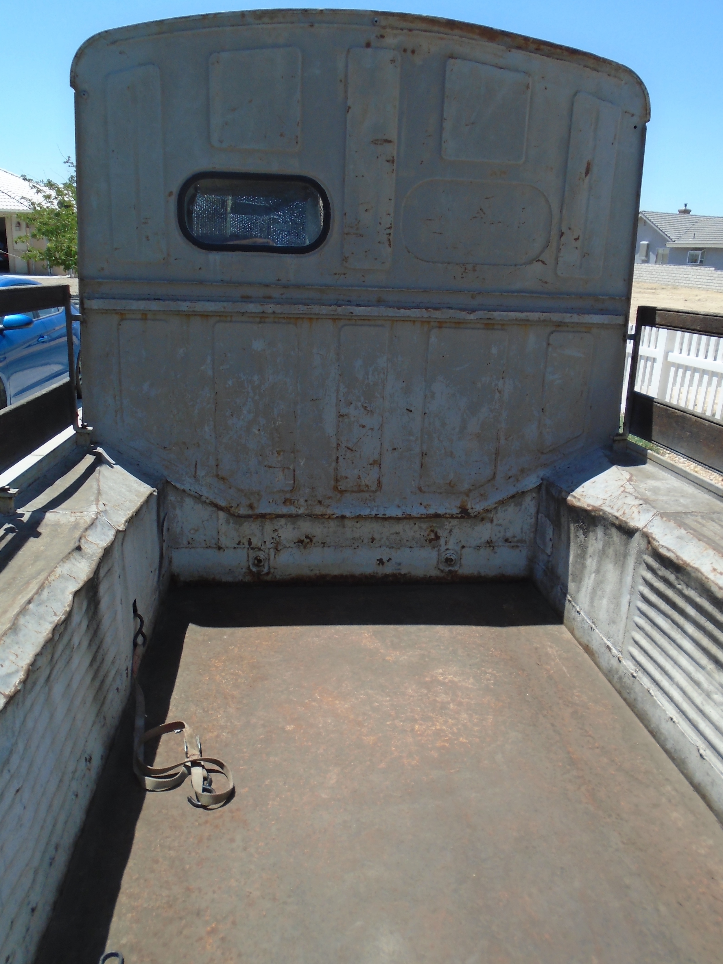

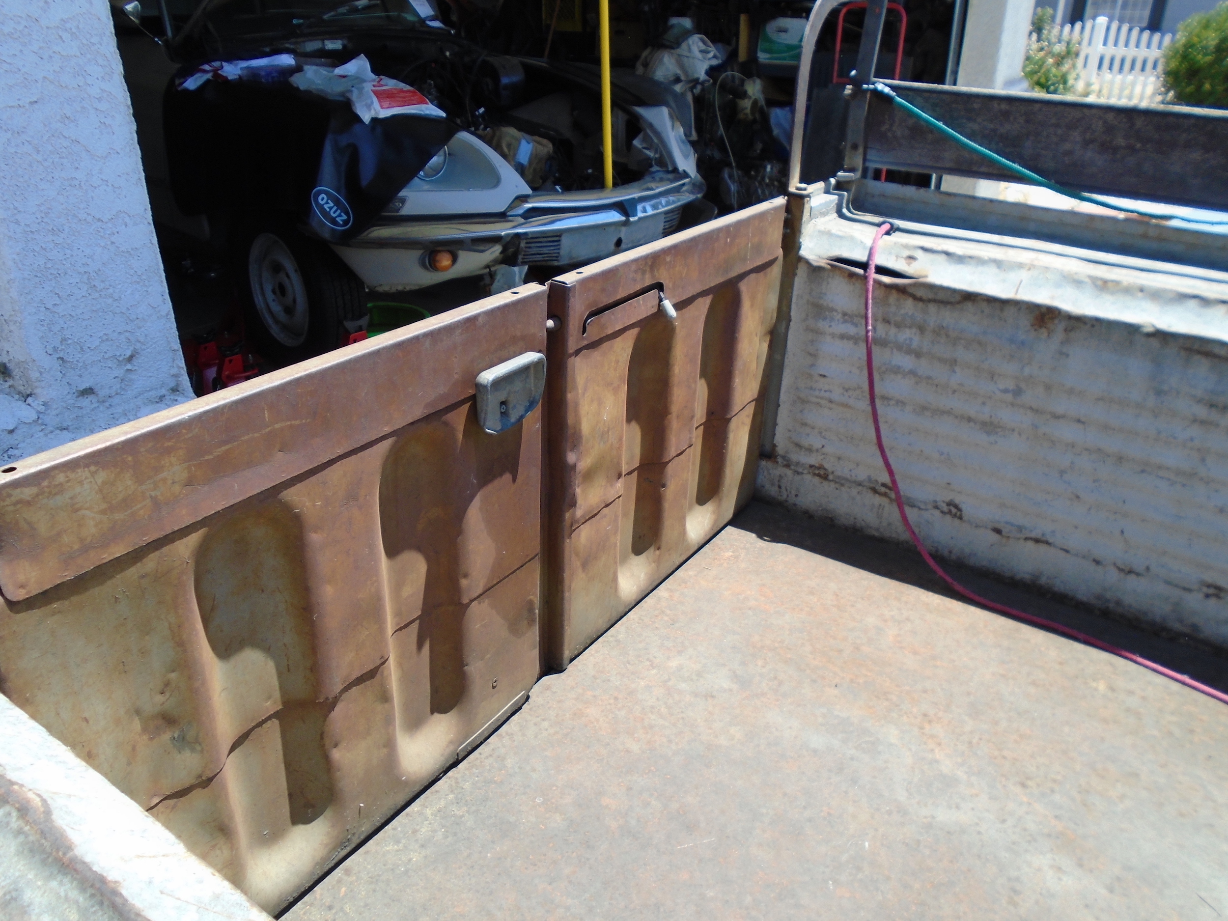

Hi Gert, here's a few more photos.
One of the previous owners imported this from France.
I'd like to add wood to the bed. Anyone have a good way to do this?
Best Regards,
Garric
Best Regards,
Garric
First coat of paint the bed.
Best way to get some space between the metal bed and the wood.

You're from the land of pickups, there must be a lot of knowledge there?
I would indeed raise the bed a bit, probably by means of some small beams (like 2x5 cm spaced 30cm or so) lengthwise and then - I'm not sure if google translate does this right - concreteplex (as in: layered plywood boards topped in epoxy, often used as casts for concrete). Or you could use outdoor wood like douglas or treated wood.
Or fully glue the wood to the floor maybe, but I'm not a fan of those kind of almost irreversible changes
And indeed paint the floor first with an epoxy(-like) paint (I don't know POR-15, but seems to be a rust stopper?)
I think most HY's never had a wooden floor in them, maybe some wooden rails to be able to roll barrels of wine

ugly american
- Berichten: 176
- Kenteken: hy78,hy72
- Locatie: deer isle , maine
yes you definitely should not have drilled out the bed. the truck just needs a canvas cover if youre really worried about it. all truck beds rust just clean off the rust and paint it. or store it inside. i have two trucks, and for one i made a cover myself.
